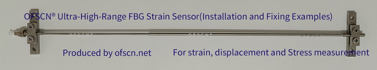

The product is a high-range fiber bragg grating strain sensor (FBG strain gauge) used for strain measurement. It is a single-ended structure that can be inserted into the test object for strain measurement, fixed using fixtures, or adhered with adhesive tape for strain measurement. The maximum range is approximately 25000 to 30000 microstrains (30000με).

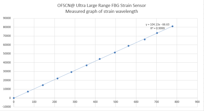

The product mentioned is specifically engineered to handle extreme strain levels, reaching a maximum range of 25,000 to 30,000 microstrains (με). This is significantly higher than standard FBG strain sensors, which usually operate within the ±1500 to ±3000 με range.
Key Product Features:
  • Measurement Range: Up to 30,000 με (approx. 3% elongation).
  • Structure: Single-ended design optimized for insertion, immersion, or surface mounting.
  • Encapsulation: Utilizes a seamless steel tube package (or similar robust housing) to ensure the internal FBG is protected while accurately transferring external mechanical strain.
