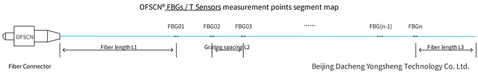

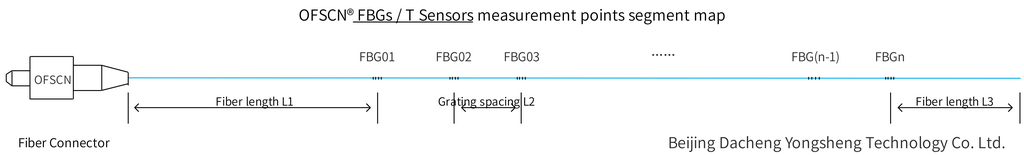

OFSCN® Fiber Bragg Grating (FBG) sensors are inherently immune to electromagnetic interference (EMI) because they are entirely dielectric. This makes them ideal for use in high electromagnetic field environments like MRI, as the sensing principle itself is unaffected by magnetic fields. However, for any FBG sensor system deployed in an MRI scanner, its packaging and any other associated components must still be constructed from non-magnetic materials to ensure MRI compatibility, prevent image interference, and maintain safety.
You can find more technical details about our FBG sensors, including their EMI immunity, on our website:
OFSCN® Fiber Bragg Grating Strain Sensor
