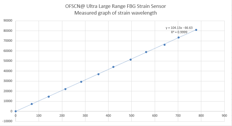

For displacement measurement, you would typically use an OFSCN® Fiber Bragg Grating Displacement Sensor. This sensor extracts displacement from strain measurements, and its structure is similar to our strain sensors.

Here are some standard product images for reference:
You can find more detailed technical specifications for these sensors on our website:
