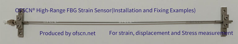

Here are some standard images of the OFSCN® Alloy Tube Packaged Fiber Bragg Grating Strain Sensor:
