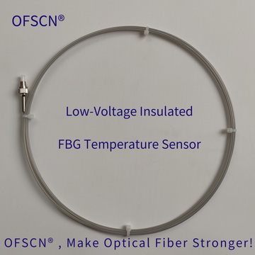

OFSCN® offers a range of Fiber Bragg Grating Temperature Sensors designed for various temperature environments, utilizing these principles for precise temperature measurement:
OFSCN® 100°C Fiber Bragg Grating Temperature Sensor
You can find more details here: OFSCN® 100°C Fiber Bragg Grating Temperature Sensor -
OFSCN® 300°C Fiber Bragg Grating Temperature Sensor
You can find more details here: OFSCN® 300°C Fiber Bragg Grating Temperature Sensor -
OFSCN® 500°C Fiber Bragg Grating Temperature Sensor
You can find more details here: OFSCN® 500°C Fiber Bragg Grating Temperature Sensor -
OFSCN® Ultra-low temperature FBG temperature sensor
You can find more details here: OFSCN® Ultra-low temperature FBG temperature sensor
